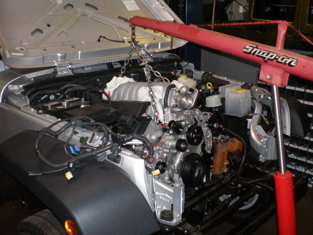

I have done the swap, but can't get it to run. You use the ECM from a WK, but we are having issues with no start. The Ecm does not recognize the APP, and there is an issue with SKIM. The PCM doesn't supply ground to the starter relay, and the TIPM doesn't supply start signal to the start relay. Burnsville Off road is the only one that has figured it out, but he is not telling anyone how he did it. Good Luck
